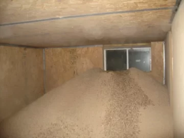

I had a little over 9 tons of bulk pellets delivered yesterday and everything worked great. I even got a little lucky as I had ordered the commercial grade pellets but they filled the bins with their consumer grade pellets and they didn't want to empty the bin and refill it so they gave them to me at the same price!
The only thing I need to do before the next delivery is build a couple of brackets at the top of the bin to hold the hose up in the sir so the hose doesn't get plugged.
Sorry, I didn't take pictures of the delivery. I was too busy helping the driver get the hoses set up.

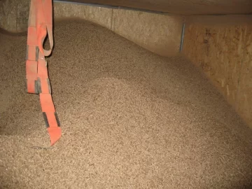

Yup, that's my bin. I only have to make one modification. I need put up two brackets attached to the ceiling to keep the hose suspended in the air. We put the hose just inside the casement window and that worked well for about 5 tons then the hose got plugged because the pellets blocked the hose.
So I had to open one of the doors and pull the hose further into the bin and screw a strap to the ceiling to keep the hose in the air.
Next time I'll pull the hose through both brackets and when the bin is about 1/2 full I'll pull the hose back to the first bracket.
There is no bulging of the walls so my design works great for at least 10 tons and I suspect even fully loaded I shouldn't have any issues.
Andy

The problem is if you don't suspend the hose above the bin they will eventually build a pile in front of the hose and plug it up. By suspending the hose at the top of the bin they can't stack themselves high enough to block the hose.

Here are a couple of pics.
  • [Hearth.com] Received my bulk pellets yesterday
I'm looking forward to using them!
