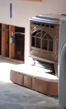

This is an early model from when they were first made, I can't be sure of the exact date as I am not at that house, but mid 2000's. My husband was a Quad dealer and he passed away in 2010. Thank you for staving off a wild goose chase on my part looking for a hopper switch.
I forget the official color, but it is beige with brown flecks. I don't think they make them in that color anymore
Here is a not very good picture of it, cropped from a larger picture.
