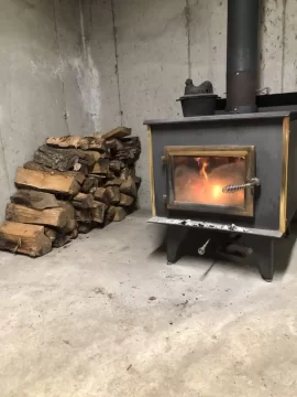

If you get a chance post a few pics of your stove and its location/setup in the basement. Any chance you have a walk out basement?The more details you can provide the better.

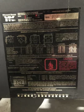

Many times you will have a tag on the back of the stove identifying the make/model. Post a pic of the tag if possible.

What kind of stove is it? Warnock-Hersey is not a stove manufacturer. If it's an old stove or needs work, might be a good time to upgrade.

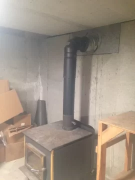

Moresnow, thank you for the response. Haven’t thought about the issue since last spring until last night when I woke up to CO detector sounding about 55 hours after I last threw a log on it and let it burn out. Yes, it is a walk in basement, double wall flue. The picture I attached is the day I did the flue, no the cardboard is not still right next to the stove. From there is goes through the sheet metal thimble made to go through the old window and up the gable end of the house, outside the house, inside a vinyl sided “chimney”. Will get more pictures of the set up after work today.
