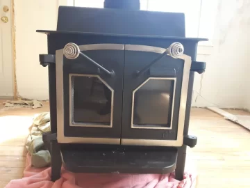

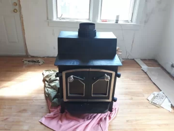

This is my first post on this forum, about my first wood stove in our first home.... So many firsts!!
I'm just looking for advice on reducing clearance to our drywall walls for installation. What I have been told so far:
Any advice on this topic or even general wood stove advice and considerations are much appreciated. I always grew up with a wood stove but this is my first time ever having to install and actually operate one.
I apologize, as I'm sure I've missed some critical information that would aid in providing a response but hopefully I should be able to come up with it.
![[Hearth.com] Recommendations for sheet metal heat shield & hearth for a Fisher Grandma [Hearth.com] Recommendations for sheet metal heat shield & hearth for a Fisher Grandma](https://www.hearth.com/talk/data/attachments/230/230089-76b6ace4b0933bbd7aa76aba8abbdc16.jpg?hash=IhVBVgT42s)
- The sheet metal would need to extend 18" on either side of the stove and 20 " above the height of the stove.
- 1 " space between sheet and wall
- 1 - 3 " between the sheet and the combustible floor (guessing a non-combustible platform of brick or concrete needs to be built to achieve this)
- Minimum 29 gauge sheet metal
