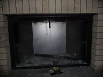

I completely took out the fireplace and there is no metal tag anywhere. It is a metal insert and there is a "facade" to cover up the metal fireplace. The fireplace measures 24" in the back, 36" in the front, 26" tall and 24" deep. I am pretty sure it is not a Heatilator. The house is 1500 square feet and is a tri-level. We walk in on the main floor which goes upstairs and then down stairs from the main level. The master bedroom and bath are upstairs. The main floor we walk in on is very open. I can't figure out how to post a picture, but will when I figure it out. Thanks for the help...
Thanks for the links! Lets see if I can do this. Here is the opening. I am still looking for what might work here. Thanks again!

Does anyone know if a Regency I1200 will work in a metal pre-fab like in the above picture?
