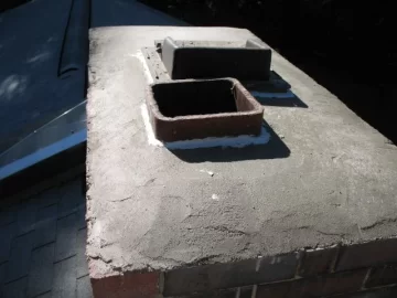

Well the cement is partially cured and I caulked the space I left between the flue tiles and the cement.
You can see my dilemma now concerning the chimney top. I have to take of the damper and put the liner down that flu. My current top is only 8" high so I will have to buy a taller one in order to use the standard top for the liner and still have enough clearance between it and the chimney top.
What should I use to seal the cement? I did add an additive to the cement to improve the water shedding but still need to seal it.

Could use some roofing tar and stone dust on top of the cement, or find someone with a little concrete floor epoxy left over and use that.
