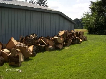

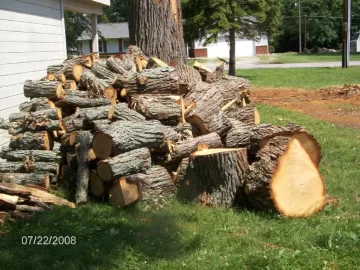

From 1994 to 1998 I heated with an Earth Stove 100 that was in my house when I bought it. I have since moved and picked one up this summer to heat my 32x40 pole barn. It has a gas furnace which I'll use to take the chill off until the stove gets going and mostly I'll run the stove on weekends when I expect to be in the shop most of thel day. I need to get stove pipe and the chimney. I used to call my old stove, a wood eating stove. This stove is intended for 8" piping, but I was wondering what would be the consequenses of using 6" stove pipe and 6" chimney. I'm hoping to save some coin on the chimney parts and slow down the burn rate.
Since I had one before, I am pretty sure I would have plenty of heat using the standard 8" chimney. For fuel I'll be using an oak tree that came down earlier this year in a a storm.

Use 8" pipe, it doesn't look like draft will be an issue, so no need for a draft damper. As for the oak, it may need another year of seasoning before burning.
