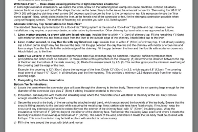

The liner's instructions say mortar the tee snout into place....[Hearth.com] Refractory cement or mortar?
This is the refractory cement I purchased....
Says it can fill large holes in masonry and holds its shape while drying.
I dont disagree with the manufacturers instructions. You just have that sized opening that is a nightmare to fill without the fill material cracking. The Rutland castable says it will do it though, so I'd say full speed ahead.
