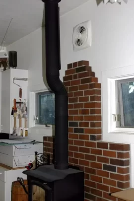

Here's our offset. Note there is a 6" connector between elbows. I was dead set against it at first. Now I hardly notice it.
LOOKS GOOD!
Maybe a more informative pic for you & the wife to ponder. Doesn't really matter to the pipe where (vertically) the offset is installed. For clearances it might, depending on the installation configuration. Our Lopi pipe offsets toward the rear wall, like BG's, but clear up near the peak of the cathedral ceiling. Can't show you a pic of that one, 'cause it's all masked off for painting right now. Rick
EDIT: Very interesting what you related about all the conflicting info you got from the diferent installers. And I mean interesting in a somewhat disturbing way.

Tim consider putting the elbows at the top of the connector, they're even less noticeable up there.
