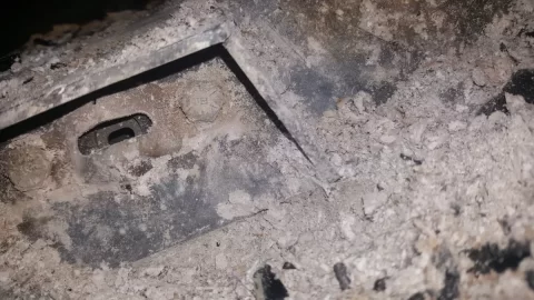

Not sure if I have a restrictor plate or not. Tried to look this AM but couldn't really see. Took the attached pic with my phone.

That is the restrictor plate, remove those 2 bolts and you should be able to pull it up and out. Also if the inside top of the stove is all cast iron, it should be the newer model that has the restrictor plate.

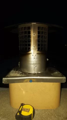

The cap in the picture is pretty close to a 6" OD so I think I can just remove the 4 screws that hold the rain cap in place and put a 6" pipe around it. As long as the change in diameter from 5" to 6" isn't going to cause an issue.
Also, the fireplace installers say they'll have to bust off that clay pipe flush with the top of the chimney and then install the stove pipe there. Is that the correct way to do it?

Wife and I have decided to have the 4' extension installed. Can someone please tell me/show me the proper way of doing this? The fireplace supplier/installer wants to chisel the clay flue liner flush with the top of the chimney. Is this correct?
Have you tried the temporary extension first and did it make a difference?
I'm thinking that they want to bust off the clay tile flush to have the whole top support the extra weight instead of smaller tile. Just a guess.
