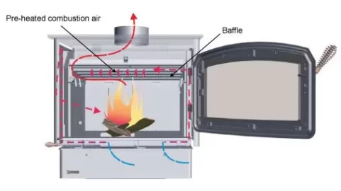

1. Yup there is only one air control on these stoves. Most non-catalytic stoves work the same. Cool air for combustion comes in on the bottom is run all the sides of the stoves where it heats up and then is brought into the stove at the front, bottom, and in the air tubes where it is mixed with the unspent gases creating a secondary burn.
(broken link removed to http://www.regency-fire.com/Buyer-s-Guide/FAQ-s/Wood-FAQ-s.aspx)

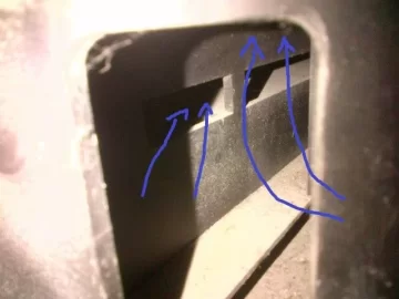

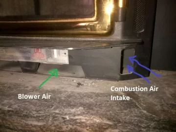

The insert is the same process and the air control is still in the same place but you'll notice two air intakes on the sides of the two blower ports. (In contrast to the combustion air on the side of the stove, the blower air goes under then around the back and out the top.)
[Hearth.com] Regency  Classic™ I3100 L insert Questions [Hearth.com] Regency  Classic™ I3100 L insert Questions

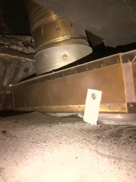

2. I can't speak if this is best practice but because of the clearance with the stone hearth I have an expandable off-set box. It adds another step when you are sweeping out but it does have a clean out in the front. (pre-cleaned pic)
