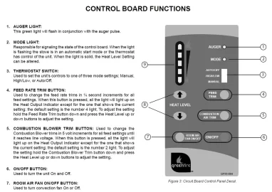

So my stove allows me to set the feed rate time from 1-5. Problem is I don't know which is the fastest and which is the slowest. I assume that 1 is the slowest but the manual doesn't really say. All is says is the following. Any idea? I don't have a mag gauge to set the damper so I have it wide open with the combustion air trim maxed (5/5) and the feed trim on 1/5. Stove has been running good this winter but just wondering if I need to tinker with things...
FEED RATE TRIM BUTTON:
Used to change the feed rate trims in ¼ second increments for all
feed settings. When this button is pressed, all the light will light up on
the Heat Output Indicator except for the one that shows the current
setting; the default setting is the number 4 light. To adjust the setting
hold the Feed Rate Trim button down and press the Heat Level up or
down buttons to adjust the setting.

I assume that 1 is the slowest but the manual doesn't really say.​
You are correct. I have the Enviro M55 and it is the same setup. I would, however tinker with the combustion trim if you have the damper all the way open. Does your burnpot seem almost empty all the time with a lot of air blowing through? You may raise your flame a bit by lowering your combustion trim to 3/5. Obviously, depending on the pellets this could change. It doesn't hurt to adjust these trim levels some to see what gives you the most active, full flame.

I had my installer call Enviro today because I had put stopwatch on each of the trim settings of my Enviro mini and the results did not tally with how I was reading the instructions. As I had thought, the higher you go to setting 5 the longer the time pause before the auger is triggered to move. Go down and the time gap is shorter. Up for a longer pause and down for a shorter pause which, I think, are in half second increments.
Interesting. I'd been assuming it was the opposite.
