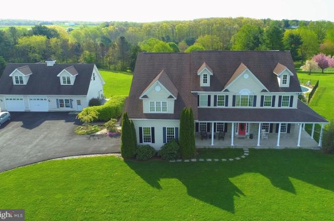

Chimney is already in the stand alone "garage". The garage is actually the equivalent of another house on the property. It has an in-law suite. Ultimately, I will be using the garage as my office. The lower level of the garage is half garage and half office (i.e., half of it is finished space). The stove will be going into the 750 sf finished room on the lower level of the garage. Going to keep the door to the upstairs level open so that heat will hopefully flow up the stairwell and keep the upper level decently warm. Since the garage was permitted and the chimney is already in place, I am going to assume that I can install the woodstove. However, I am not going to assume that the clearance to combustibles is adequate for the enclosed chimney. I am going to open up the walls and take a look at it. Better to redo drywall and paint, and redo the chimney if necessary, versus having the garage/apartment burn down.

Yep, aesthetic reasons. Out back there is a large stamp-crete patio with a grill and a pool. The house would look like crap from the back with two stainless steel chimneys running up it side by side. The garage has the chimney running up the back wall but it is inside the garage and covered by a box of drywall with a penetration through the roof very close to the back wall. That install was by design and clean on the garage, which was built after the house so the husband's mother could live on the property. In the main house, the fireplace in the family room is a gas fireplace and then there is a hookup for a gas fireplace in the basement. Going to change both of those to wood stoves and run the flues up a stone chimney to match the front of the house. Hopefully, I can recoup most of my investment over the 20+ years we plan on being in this place.
