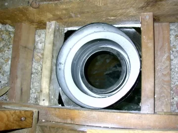

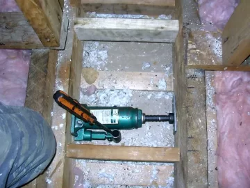

When framing the support box, I had to use a hydraulic jack to push back one of the ceiling joist as it was somewhat warped. I used wood screws for everything so I could make adjustments if necessary. This turned out to be a good idea as a few things need some minor repositioning.
Support box installed. I used some scrap wood screwed to the ceiling to hold the box in place.

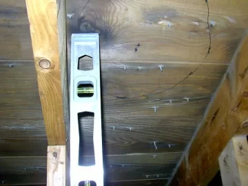

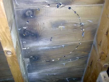

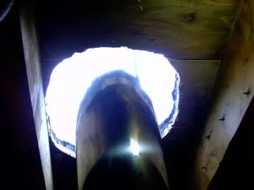

I installed the 4’ chimney pipe and used a level placed against the outside of the pipe to mark the hole in the roof, then I drilled a bunch of 3/8 holes. I then used a sawzall to cut the hole in the roof. I had to go back and enlarge the hole in a few places to achieve the required 2” clearance.
I pried up the shingles on the upper half of the roof hole and installed the flashing; I used some polyurethane roof caulk to seal the flashing. I sealed up the storm collar with hi temp silicone and installed the cap, chimney was done.
