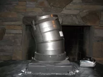

I'm relining my flue. 2 questions. Any tips on bending the ss liner? and would turning my elbow to the left bother anything? The liner would install easier and with less resistance. Pics attached, thanks.

You can turn that fitting any angle you want. Is there a reason that you have that Lopi adapter on there? It is typically used only to move the flue back a few inches, by using this it would eliminate the need for an elbow. Since you have an elbow I think you could take that adapter off, it would be easier to clean without it, as it has an offset that can collect creosote. There should be 3 angle brackets that came with the manual that you would use to secure the fitting to the stove top.
To bend the liner you can use a 2x4 or something similar to reach up there, use it kinda like a fulcrum. Be careful not to kink the liner.

Let me explain, my stove sits out on the hearth so I need the adapter. If I could gain a few more inches it would be even better. If I sit it flush, it would be a heck of a lot easier, but I kinda like the look of it sitting out on the hearth. Maybe I'm wrong, but I would think you lose a lot of radiant heat with it flush? I'm not sold on the offset boxes, so the adapter it is. Thanks for the 2x4 trick. Obviously, not looking to put a 45 in the liner, just persuade it some. Maybe I'll try it without the adapter to see what happens. That stove was installed years ago, so those 3 brackerts aren't around.
You would lose some radiant heat by flush mounting the stove, that was better for me. We want to see the fire all the time, but only need the heat part of the year as it isn't our primary heater. There is nothing wrong with that adapter, it is more solid and easier to clean than the offset adapter.
