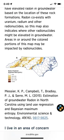

Wake and Franklin counties have testing available. Here is map. I found and the link.
Chances it’s in the water and is high are probably only if you live in the colored areas. My shower test was just to try to get something above background. The detectors I used had hourly sample times. Let the shower run 10 minutes every hour and keep the door closed might give you an indication that you need your water tested. I would check with neighbors and see if they have ever had the house or we’ll water tested.

Thanks for that link. I live in one of the kind of "spotty" areas.
With a well it’s worth sending a sample off to get tested. There was a link somewhere to get a list of companies that do the testing. An email or call to the county health department asking how to get a radon water test is probably a good idea. There were wells in Maine that the sample bottles literally opened like a soda bottle because of radon. We know much more about it (compared to 50 years ago) and have mapped the geological formations that are likely to contain uranium but when it come to wells unless all the wells around you are at the same depth there can be more local variability in radon water concentrations as opposed to living space. But to be clear even if it’s in the water it’s still the inhalation that’s concerning more than the consumption.
