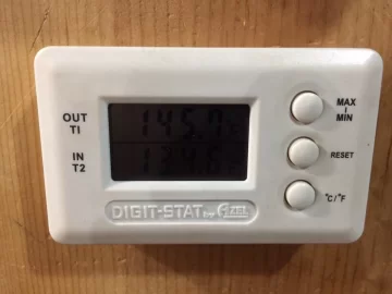

I have my tank temp sensor reading out via a simple device that displays 2 temp readings (too lazy to go downstairs to see what it actually is). It is simply connected via thermostat wires so if you want to run wires I imagine you can mount the display anywhere. I would imagine you could use the exact same thing for supply/return temps. My system uses a temp sensor that is similar to a probe that drops into a Indirect DHW tank. Mine run back to the boiler that controls a mixing valve but I imagine you can run it back to the same type of display that I use for the tanks.

You made me walk downstairs:)! It is small, maybe 3'x4"
  • [Hearth.com] remote temp sensors

I have (2) of the Azel (Digit-Stat) units and they work great, powered by a watch battery. At the end of the season I take the batteries out and put them back in the next season. I usually get 2 seasons (12 months) out of the batteries.
