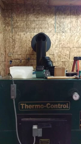

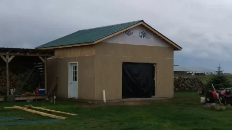

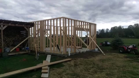

My boiler setup isn't 100% finished yet I still have some piping left to do , basically I built a 20x20 workshop to process deer in out back of my house about 95 feet away , I have a 2 year old thermo control boiler I bought that I put in there , 1" Thermopex installed in the ground . My house is just a single wide trailer that I have a main loop under it going to my sidearm first and then back to the furnace . On the primary loop under the house I will install 2 closely spaced tees going to my furnace coil about 35 feet away with its own pump hooked to a taco pump control box . The top of the boiler in the building is about 1-2 feet below the coil in the house and 2-3 feet below the sidearm in the house . The pipes in the building have to go up 10 feet to the ceiling , then along the wall 20 feet then down to connect to the Thermopex comming out of the floor to the house .
