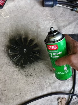

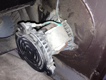

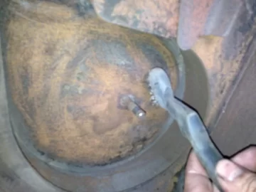

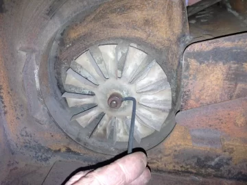

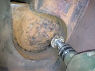

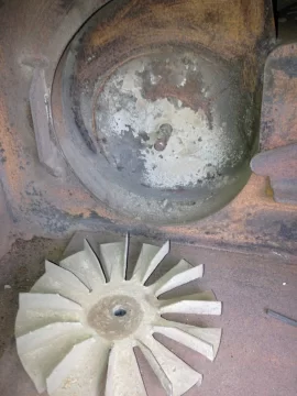

There certainly is a trick! When a set screw gets frozen from oxidation the portion that oxidizes is the surface between the screw and the threads. Even though it may not look different. Therefore if you use a wire brush and brush all around the edge of the set screw as hard as you can then spray with PB blaster you should be able to loosen the screw by hand with an Allen wrench. I use a wire wheel on my drill/driver to do the hard brushing! It work on a 12 y/o P61 so it should work on most stoves barring an extreme rusted out case!
I also use VHT Flame Proof very high temp flat black on both sides of the combustion retainer assembly that goes over the impellers! That keeps it from rusting!

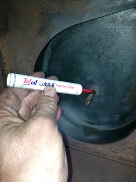

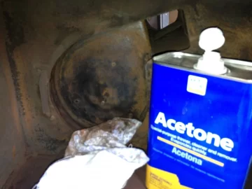

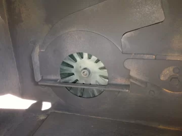

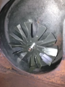

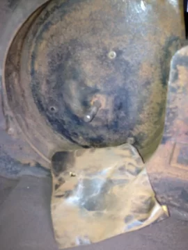

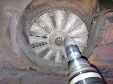

Here are a few pics. Hope this helps
You can see my drill/driver wire wheel and wire brush, the emery cloth, Acetone and the dry moly I use to make it clean and really smooth!
You can either buy a nice new combustion blower impeller or if yours cleans up well, just dry moly it and it will be smooth running especially with some Tuff-Oil Lubit-8 on the shaft!
