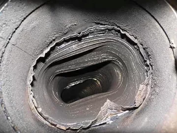

  • [Hearth.com] removing fireplace damper
so you ovalize the last little bit to make it through the damper, then what, do you use an oval to round adapter to connect it to the stove?
I would not ovalize my liner at all, you reduce the draft and choke it off in that area by doing so.

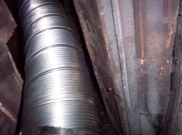

here is a photo of how I clearanced my damper sides to fit the 6" SS liner.
I scored it with a grinder, started each notch with a sawzall ( or jigsaw) and then it broke off with a large pipe wrench to get leverage on it.
I cut mine with a sawzaw & an angle grinder. My liner came just about straight down onto the stove outlet.

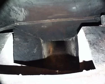

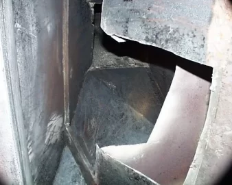

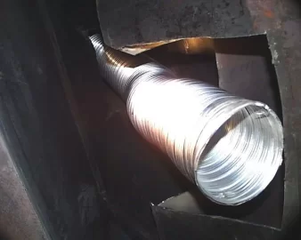

Heres a few photos.
The flex pipe in the photo is 6" aluminum I bought at Home Peehole to use as a mock up for the real liner. Came in handy when checking for fit & clearance. Was like $6.00.
