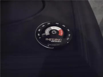

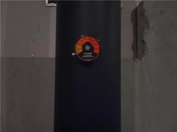

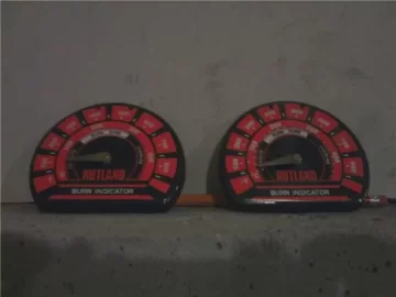

Out with the old......and in with the new. I've gone through 4 Rutland thermometers, 2 broke and 2 read anywhere from 50-100 degrees different. Decided to get the new Inferno for the stove top and the Fluegaurd probe thermometer. Anyone here have any experience with the accuracy of Condar products?

those look allot easier to read

I can't speak to every Condar thermometer . . . or the accuracy of my probe thermometer . . . but the Condar thermometer I have on my stove top is pretty close in terms of temp when I compare its temp to the temp reading I get from the IR heat gun.
I tried two Condar FlueGards (probe-type) and both were way off, in the oven test they were both reading ~1500-1700F (i.e. one was just below the 1600, the other was redlined) with the oven set to 450F. Took 'em both back and got my money back. Bought an IR thermometer from amazon (Raytek MT6) .... it's all I use now. I have a rutland magnetic like what you just got rid of, I find it's usually around 50-100F low on its reading. I keep it there more for my own amusement now.

Your picture of two thermometers showing two different temps proves the old saying "a man with one watch knows what time it is, with two he is never sure."
The Inferno you show in the picture looks very well thought out, I like it, easy to read is a good thing.
