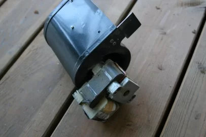

Does anyone out there know what model number (manufacturer FASCO) the blower motor is inside the front blower of an Avalon Rainier? The whole blower assembly is $300 here in Washington State. Argh. One motor still blows, one is burnt out. I've drilled out the rivets and have the motor in front of me. I've spent 2 hours on the net trying to find a match, or replacement. Any help is very appreciated! If anyone has a dead blower motor assembly, pulling one of the motors our should reveal the maker and model number, mine however was burnt black and unreadable.

I think I just found it by matching frame shape and shaft length. I just ordered a K612 bathroom/ small exhaust fan from emotorstore.com for $25. It was the only one with the correct shaft width and length and the picture looks just like mine except not burned and melted.
I will be so juiced if it works. :cheese:
The motor did work!
It matched perfectly and when I built a fire and it kicked on for the first time, I jumped up and did a little "Who Da Man?!" dance in the middle of the living room.
