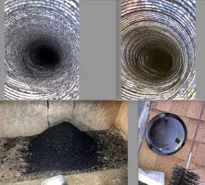

If you can find new ends I'd use epoxy. I used to build custom golf clubs and I used a two epoxy to glue metal and graphite shafts in the heads and that I know I never had a failure. If you got a friend with one of those mini metal turning lathes or even a regular metal turning lathe they would be easy to make. I'm a retired Journeyman Machinist.
BTW: I use the same system of Rutland rods and nylon brush. I can see the day coming pretty quickly that I'm not going to be able to get on the roof to sweep it anymore. My son puts me on the roof with a loader tractor and a pallet, can't deal with ladders anymore. My insert goes out the back at a 45˚ angle and then just straight up. I don't believe I could push it from the bottom regardless on the rod length. It's hard enough to push them down from the top. I always tie a rope on the end of the brush and drop it down just in case I get it stuck.
Before brushing, After brushing, what came out and the cap(no cleaning of the cap) I burn pretty hot I don't like smoldery fires.
