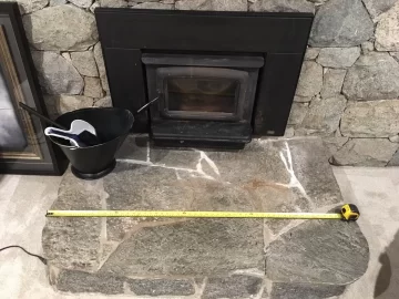

Looking to upgrade an existing small wood stove.
The masonry opening is:
26 Wide
23 Deep
20 Tall
The hearth is 30 inches long, 53 inches wide.
current stove is
22.5 wide
15 deep
17 tall.
I would love something that would project out on to the hearth 12+ inches.
I've contacted a few places in the area. They simply tell me what they have won't work, but not WILL work.
Anyone have any ideas/recommendations on what i could get in that space?

My outer hearth is 8 1/4 inches tall.
If i made my outer hearth level with the existing concrete floor, would i then be able to take a few inches out of the inner hearth to make the fireplace opening larger?

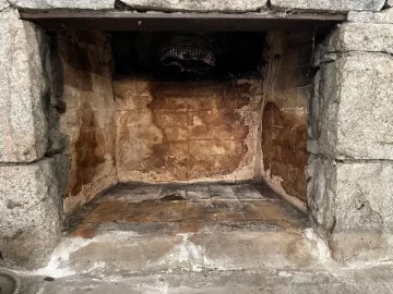

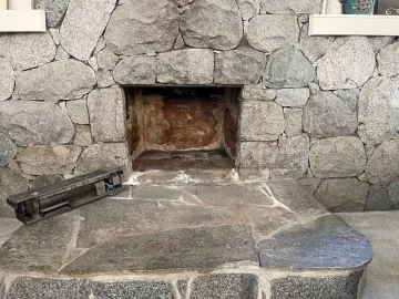

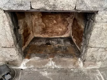

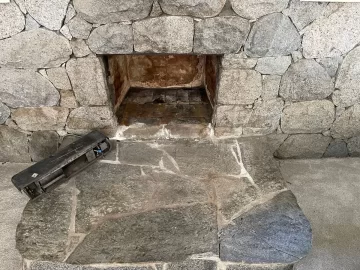

I was able to get my old stove removed.
Thus allowing better measurements.
24 3/4 Wide (narrowest at the stone opening.)
21 inches deep (back wall to opening)
20 1/4 Tall (at the opening, lip to the metal cross bar.)
The hearth extends out another 36 inches from the opening of the fireplace.

It's probably a PE Vista insert which is 19.25" tall, 1.6 cu ft firebox.
Right now the 20" opening height is the deciding factor. If the big hearth was removed, then a big rear vent stove like an Ideal Steel or Progress Hybrid could be installed at floor level. Another alternative would be to raise the lintel. If the interior hearth floor has also been built up, then it might be removable, but it's important to know what's underneath this first.

How is the hearth constructed? Is it stone veneer on a wood-framed box? If so, that may be the easiest change to get a large rear-vented freestander in.
