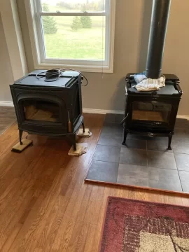

Just in case you want to see a T5 an and Ashford side by side.
  • [Hearth.com] Replacing Ashford 30    Stove suggestions?
