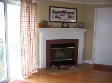

My husband and I have a 1900 sq. ft. two story home and we are looking to replace our pre-fab fireplace with something wood burning that will heat at least our first floor 24/7 without using any oil. Because the inside height of the actual firebox is less than 16'' we cannot put in an insert. We are trying to avoid knocking down the entire corner wall in order to keep the mantle that my husband and father built. We can rip the whole fireplace out, but then we are trying to figure out our options. We'll have a big open space, so can we...
A. put in an insert without doing anything to the space behind
B. somehow fireproof the space behind and then put in an insert
C. somehow fireproof the space behind and place a free standing stove partially into the opening
Right now we have a 25" hearth of ceramic tile over regular plywood which can be expanded somewhat, but not too far because we are dealing with a door and a main traffic area. Our current chimney is stainless steel- we think 6", so we're not sure if that will need to be changed or not.
The "advice" from the people we have talked to at the stores we have visited has not inspired much confidence on our end, so I thought maybe we could get some soild answers here! Thanks so much!
Laura

That is a dilemma. I had to take out my homemade mantel, it took me a few years to get up the gumption to do it. But I don't see a lot of alternatives for this location due to the doorway.
My first approach was to consider something like a Hearthstone Homestead or maybe a Jotul or Castine in front. But the door and traffic present an issue. However, the Castine could get away with a flush hearth extension. But there will still be a clearance to combustibles issue with the mantel.
If this is the best location, then perhaps the best solution for good heat is to take out everything and put a close clearance freestanding stove in place of the current fireplace. But let's see what others have to say.

Ripping out the old mantel and corner wall, while painful because of the labor that went into the mantel, is not that big a deal. It could be done in a few hours with the right tools. This would allow you to install a close clearance stove in the corner that could look great. It could even have a perimeter mantel up a little higher. Just a thought as you are weighing options.
