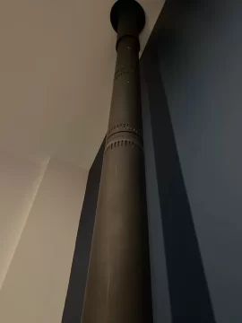

New to the forum here. We've just moved into a new home in the Allentown, PA area. It was a former barn built in 1890 that was renovated in 1989 and that was pretty much the end of all the maintenance. We are in the middle of our own remodel and I had the existing stove looked at, and, unsurprisingly, that was not well taken care of either. The old stove is a Hearthstone 1 with 8" flue straight up 17' to the ceiling and about 5' of a chimney on the roof. I've decided to replace it with a BK King after reading miles of thread on this site. The local stove shops are all saying they need to replace the entire flue inside the house without ever inspecting it. Does this seem right to anyone? I am brand new to wood-burning stoves and this seems completely illogical to me that I should replace perfectly good piping (if it is so, of course).

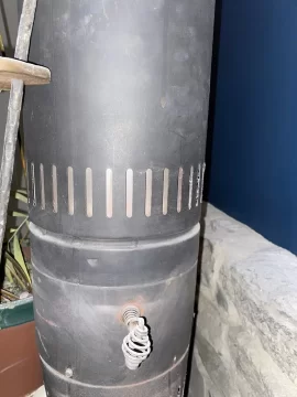

Thank you for the reply. Like I said, I’m a newbie, but that looks like a double wall pipe to me. The only thing I can think of is a liability issue for them if they don’t replace everything. But then I get to thinking that these folks should be able to inspect the piping and determine if it’s the correct stuff for the job...unless I’m missing something. Are they just trying for a money grab?

I bet you’ll be good with draft. Definitely get a second opinion on your chimney (of course the stove shops say you need a new chimney) but be prepared for the same answer. 1989 or older is pretty old.
begreen is referring to the connector pipe between stove and chimney and I agree, you’ll want to switch that out to some new double wall from 1989 (or older) single.

Update: I had a level 2 inspection done and the whole system is shot, including the chimney and support bracket up top. It will need a total replacement. Can’t say I’m surprised as we’ve had to fix virtually every other thing in this house, but definitely a pricey discovery. Oh well, it will be well worth it for years to come.

After the results of our level 2 inspection, that’s exactly what we decided. The inspector said it would cost about $2k just to clean it and reuse the 30 yr old system. With little ones in the house, it did not seem like the wisest decision to keep the old system.
