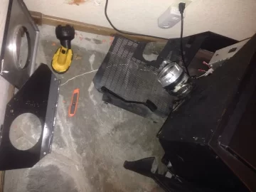

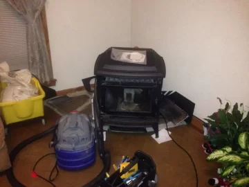

Well after reading numerous threads the last few days about the quad castile not getting enough air to the pot and pellets not burning fast enough which is building up in the pot, I decided to address this issue all at once because it's happening to me as well. I am replacing the combustion blower and the gasket, fire pot gasket, the door gasket, and updating my vent pipe to Simpson dura pellet vent pro from pellet vent. Plus a very good cleaning. I'm pretty sure the combustion blower is the original from 2004. Now I am deciding on a OAK. Here some pics.Luckily we have a stretch of warm weather (60's) this week here in North Tx.

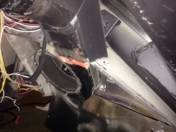

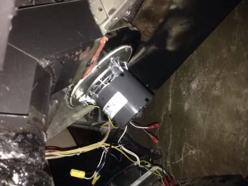

Update: Got the exhaust blower today via Mail and installed it. More parts on the way to complete the project.

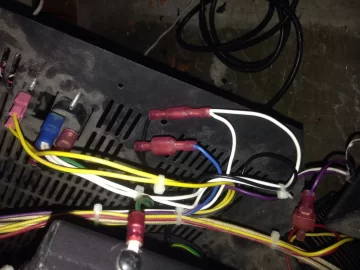

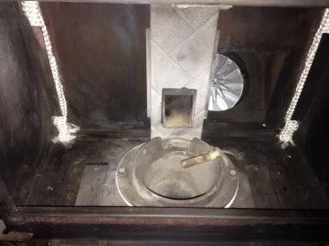

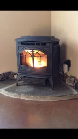

New gaskets, blower, and wire connections. Finally done here is pics. Thanks everyone for the help.

I am noticing a much better color to the flame and a cleaner burn so far. The true test will come tonight when I run the stove on medium all night. So far I have burned about 20 hours on low and have not had to clean the pot once. I hope I can get it back to only a once a week clean like it use to be. The stove will be on 24/7 starting today.
