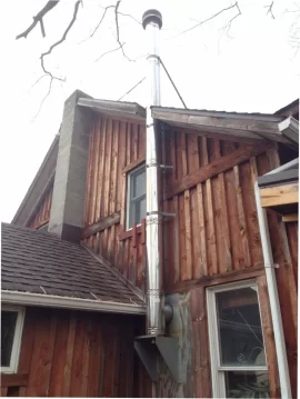

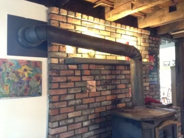

I'm going to help some friends replace their pipe from the stove to the wall thimble. A small section of pipe is corroded from rust. The inside section is a 3' run to an elbow, then a 5' run to an elbow, then out to a 90 degree T and a 16.5' length of stainless triple wall on the outside. While the draft is usually adequate, occasionally they have issues with smoke blow back. I was thinking of increasing the slope of the interior pipe. Check out the pics below. Any thoughts?
![[Hearth.com] Replacing pipe, stove to wall thimble [Hearth.com] Replacing pipe, stove to wall thimble](https://www.hearth.com/talk/data/attachments/115/115397-57ab6e3442052ffdd5c714faca485fce.jpg?hash=2LUYbV4pSW)
![[Hearth.com] Replacing pipe, stove to wall thimble [Hearth.com] Replacing pipe, stove to wall thimble](https://www.hearth.com/talk/data/attachments/115/115393-08a5de232dd4840717c1904cf50feea4.jpg?hash=w9IdA11KdU)
