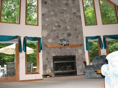

I have a (broken link removed) (Not WMC42 where the link goes, although I think it's pretty much the same thing, only difference I can find is the brick walls, mine are metal with a brick floor). Mine was probably installed when the home was built, in 1997. We just moved here, so no, I didn't pick it out.

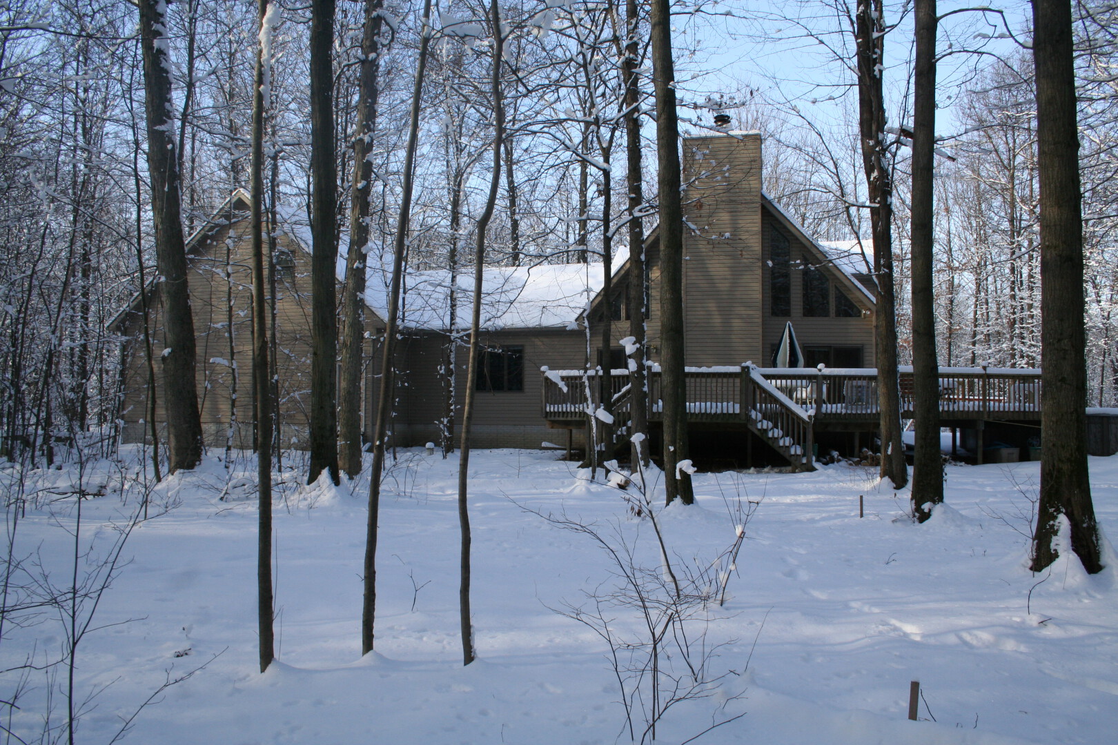

It's in a 2500sq house with 28' ceilings. 30'+ high termination, never a draft problem, installed in chase. Insulated chase? I do not know.
Picture Interior
Picture Exterior

I have a WMC42 that I'm going to upgrade some day, and I've pondered some of these same questions. (Seasonal home at the moment, so I'm not in a hurry.) You could do an insert, or perhaps a hearth stove (like a Homestead) in front of the fireplace, both with either a full 6" liner or possibly a direct connect if you do in fact have the S8 AC chimney (which is HT2100 rated). Either one will be cheaper (probably much cheaper) than replacing the whole fireplace, certainly within your budget. I too was thinking about the Sequoia to reuse my S8 chimney; based on the slop up at the top the existing chimney seems to just be sitting on the WMC42 so I suspect it would be easy to lift it as needed. The S8 seems to be pretty specific to VC, so I don't think you'll find any approve method to hook it up to another fireplace brand. I don't know if lining an existing chimney is allowed for new ZC fireplaces. There is the Magnum ZC ((broken link removed to http://www.americanenergysystems.com/magnum_zc.cfm?tabID=1)), which claims to be compatible with any 8" chimney. Has all the usual feature of an EPA stove, but doesn't actually seem to be certified.
In my primary residence I did replace a different prefab fireplace with my Ultima; this required first pulling off the surround, hacking the fireplace into pieces, and dropping and sectioning the existing chimney. This left an empty chase and cavity in the wall. The new unit was framed in, and then my installer climbed down the inside of the chase from the top, building a makeshift 2x4 ladder inside, to install the new chimney. He was the only guy I could find who suggested that approach, another one I talked to wanted to rip open the wall floor to ceiling on both floors! My installer charged me $2500 for labor, which seems high but a) I don't do heights, b) it was the best price I could find, c) he wound up rebuilding part of the chase also and d) he got me a good deal on the unit and accessories through his wholesaler. Total bill was somewhere around $5k in 2006. A hearth stove install would have run $3000-$3500, but I didn't have space for something sticking out into the room.

The tag riveted to the inside of the fireplace has Chimney is "S 8 at 2" clearance" stamped into it. There a space between the S and the 8 and I looked hard for evidence of the K that would indicate 2wall. There's nothing there. It says S 8. But I find conflicting info on if 2wall was even allowed with the unit. The website marketing page says 2 wall is standard, the manual says 36 model can use 2 or 3, but 42 model must have 3 wall. I think you found the same thing reading some previous older posts. I would tend to trust my tag and say it's three wall. I supposed I'll need to climb up to and measure the outside diameter to actually tell though. CHimney was clean as whistle when we moved in, so I never went up there to check anything. Mabey I can tell if it's has supports or not. It may just be sitting there. 30' was the max before supports were required, according to the manual, I suspect I'm just under 30'. They get premium price for chimney pipe, $240/8' section at one place. Not including installation. Ouch.
