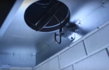

I am in the process of selling my home and the buyers are requiring the installation of a damper for my wood burning fireplace insert (who knew it did not have one?). I have had no success in my google searches to find an adequate replacement. The closest I found that would work mounts from the top of the chimney and is actuated by a pull wire, which we would prefer to avoid. I will post a pic of the type of damper I am hunting for. One local fireplace store was unable to assist and I will be visiting more tomorrow.

Are you sure that's an INSERT? Looks like the inside of a Zero Clearance Fire Place.
Is there a rating plate riveted to the box near the opening?
Often-times the plate is located behind the safety screen & is not readily visible...
That will tell you the manufacturer & model & point you towards a replacement damper...

Also I forgot to mention that picture is not of my fireplace, just a damper that I feel would work for my needs. Mine looks similar, and has two holes either side of the pipe that looks like it would support this type of damper.
Can you post a picture of your Fireplace? The picture that you posted is not a locktop damper that you were referring to, but rather it’s a damper in a prefabricated Fireplace.
It looks like you are putting new brick in it too? So it’s looking like there was a wood burning insert in this fireplace at some point?
I’m not aware of a way to replace a damper in a prefab after it’s been removed. Typically the rod holding it gets cut in two.

You cant use a damper that was not designed and tested with that fireplace system.
Is there a replacement damper listed in the parts list? I saw that one but didn’t see the option.
I didnt see one no. Probably because it is not a replaceable part. It had to be cut to come out. You could try calling the company to see if you could get one but i am not sure how you would install it. Have you had the whole system inspected? Someone hacked it up for some reason we can tell because they cut the damper out and obviously had to replace the panels probably to put an insert in there that didnt belong. So i wondervif there may not be more damage.
