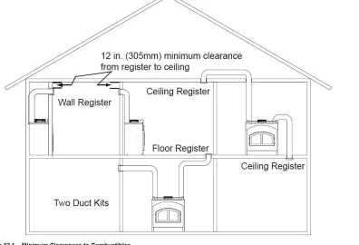

I have been considering an insert also, but I guess one of the reasons I was leaning towards replacing the fireplace itself was that I would be able to run heat ducts from it to other rooms (see diagram below), plus I've never really liked the way inserts stick out of the fireplace onto the hearth. I think a new fireplace would also produce more heat than an insert.
An insert isn't out of the question, but if given a choice, I would go with a new fireplace...
  • [Hearth.com] replacing zero clearance fireplaces
