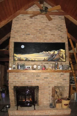

I have a somewhat similar situation to yours, except I have two stoves. I have a freestanding Jotul F600 in front of the fireplace on the main level venting with a 6" SS flex liner(no insulation) going up through a masonry chimney of about 20'. I have a second stove in my lower level that came with the house. It is a Woodstock classic and vents up through a clay tile lined 28' chimney running up through the center of the house. The stove is connected to the flue with a 6" metal stove pipe into a clay thimble. Even with that large clay tile flue (7"x11" - same as yours) the stove drafts fine and the flue stays very clean.
On the Jotul with the uninsulated flex liner I have a block off plate inside the fireplace and a sealed top plate on the top of the chimney. Enough heat comes off the stove and flex liner to heat the huge brick chimney to act somewhat like a masonry heater. I can shoot the chimney between the stove and the heat sheilded mantle with an IR thermometer and pick up temperatures over 200F when the stove is burning and still well over 100F the next morning. So, in answer to your original question I believe your thinking is correct in that you can still get some decent heat out of the chimney if you run the flex liner without insulation. Yes, you will get more creosote in the cooler running flue, but I haven't found that to be a problem during the two years I've had this set up so far.

Thanks for the great replies. Nick, that's a great looking fireplace! I would rather not knock out the clay tile flue, not so much because of the effort, but I don't think I can justify the extra expense of running insulated rigid liners up the entire length. Glad for all your input. Cheers!
