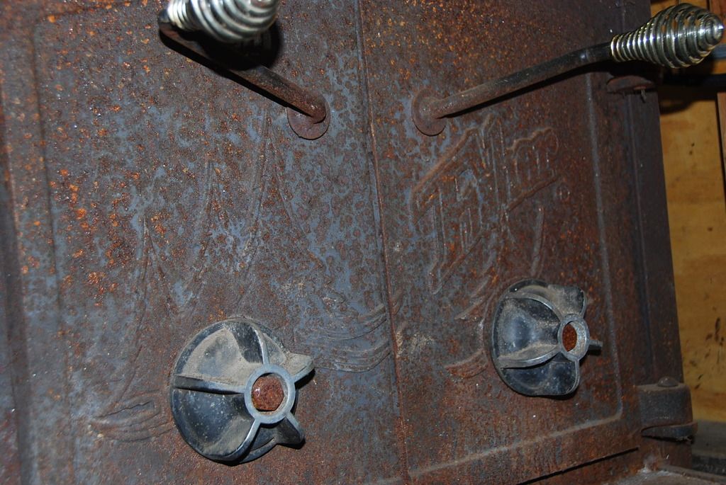

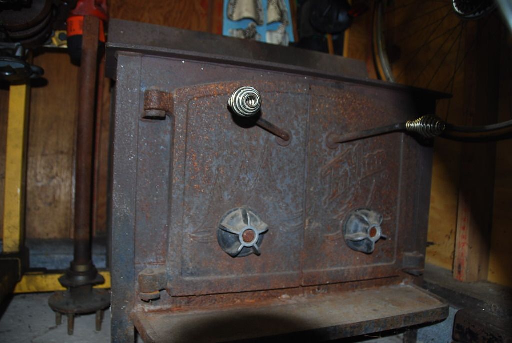

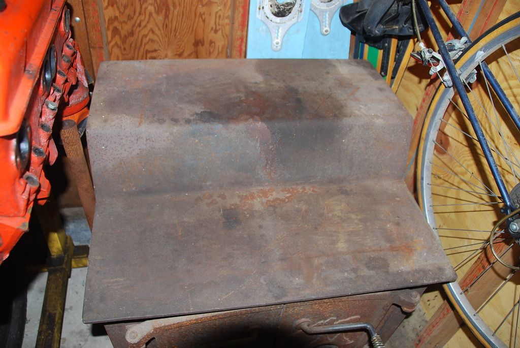

To those who have brought back to life some old Fisher stoves how do think this one would turn out? I currently have a Fisher insert and would like to replace it with something like the Grand'pa bear. Found this one Craig's list, but i'm thinking it might be too rusted to get it back to a decent finish. any opinions?

Not bad at all. Only needs a little wire wheel. Knotted cup brush is the most aggressive for bad spots. Buff the door seal and door sealing area as well. (Inside of doors don't get paint) Wipe with lacquer thinner before paint. It will go faster than you think. The draft caps get painted as well. Before final cure, buff off the edges by hand with Scotch-Brite pad. If you can, paint it outside and fire with a few pieces of pipe to smoke off and cure paint.

Was that stove black, nickel or brass plated? I have pics of new and reconditioned. Grandma or Grandpa, flat doors or arched?

If you noticed this is a a Gpa with Gma doors. When I ran out of Gpa doors I made the front sides wider and mounted the doors this way. What state did you get this?
