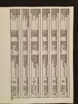

  • [Hearth.com] Rhythmic vibration and buzz from Harman 52i combustion fan
(broken link removed to https://pellet-stove-parts-4less.com/products/harman-after-market-exhaust-blower-motor-replaces-part-3-21-08639-20050?gclid=EAIaIQobChMIraOO6v6C4AIVZRh9Ch2yEgjHEAMYASAAEgLoTfD_BwE)
