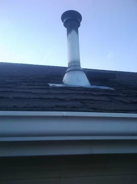

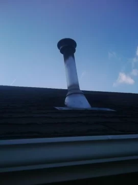

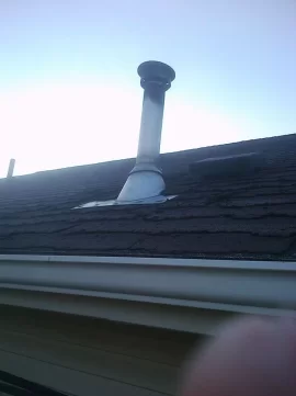

Here are some photos. The vent pipe is on the east side of the roof. There is an attic vent near it. [Hearth.com] Roof Damage? [Hearth.com] Roof Damage? [Hearth.com] Roof Damage?
The vent needs to be cleaned and that is it.
It is normal to have soot at the termination cap.
The shingle mess is just normal shingle aging from what I'm seeing and has absolutely nothing to do with that vent.
Clearance from the bottom of that cap to the nearest portion of the roof must be at least 12" and that is all folks.

5 YEARS? That roof is failed NOW.
This looks like ice damage from snow melting during the day and freezing at night under the shingles.

Vent is fine and is up to code so long as you are using a pellet stove with forced draft. Any natural drafting stove hooked up to that stack will need to have the stack 2 feet higher than and roof horizontally within 10 feet. Chimney sweeps make terrible pellet stove techs. At least they are living up to their reputation as dubious conartists.
Shingles are doing what is called pocking. Basically the surface temp of the shingles is absorbing all of the heat from the sun. Your roof should have a ridge vent or power vents to conduct the heat from the shingles and disperse it outdoors.Commonly, folks jack insulation into the soffit and block the flow of cooler air from the soffits thus destroying the roof.

I would go so far as to say to strip that roof is a must and reshingle. That roof looks 40-50 years old.
Oh my God!
That roof is toast!
In 5 years you will surely have bucket catching water inside.
