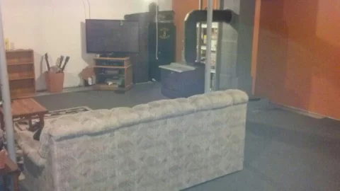

Here is the pic of down stairs[Hearth.com] Room cooler with blower on high......

So after reading all of these post I decided to do a real world test. Currently i have been running my fan on HIGH to HIGHEST on my Pacific energy Super Insert for the last 3 months. I personally figured running on high would make my house hotter. I decided to see if running on MED to LOW would make my room hotter. Well guess what, i was WRONG. Running on med to low has increased my room temperature by 4 to 5 degrees. I wish i would have tried this months ago! I am actually amazed, i guess running on high cools the air more than i thought. So there you have it, turn your blowers down. :) Thanks for starting this post.
You have been pulling cold air from every corner of the house, and some from outside the house, toward the stove room.
Our couch used to sit between the kitchen and the old insert.. The cold draft coming up over the top of the couch to get to the stove when the blower was on high would give ya frostbite on the back of your neck.,
The fans can't cool the air but maybe they can cool the stove to the point the secondary's are effected. That's whats being discussed .
I don't think one cycle or one day can be conclusive due to outside temps and wind and whatever else.
But for you if it works that is great! Cheers!
