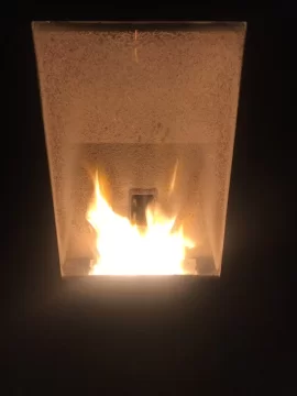

mine after 4 days of 24/7
[Hearth.com] Room temp/cold air
This is mine today after I cleaned it and about 6 hrs burn time. I could literally clean this stove glass every two days or so. It is the gray/white ash and color. Maybe it just drives me nuts because until i installed these pellet stoves ive never had a glass to look thru it was just a good old fashioned wood stove with out.
The Mt Vernon AE thats upstairs it just doesnt really get dirty. I could go almost a week to week and a half before it really starts getting dirty.
