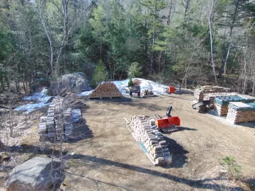

Depends on the type of wood, what stage it's at (is it already going punky?), and your climate. I've had rounds stacked for almost a year with no issues (beech, oak, ash, birch, and maple). I do split the bark on the birch if the rounds are going to be left unsplit for any length of time and I top cover the stacks of rounds during the winter. While the weather is cool with no bugs I'm just getting as much back to the house as possible and will then split later on (I already have enough CSS and seasoned for next season). The stacks on the left are from the last couple weeks however the stacks in the middle and at the back are from last fall. I would say the most important recommendation I could give would be to get the rounds off the ground if they will be sitting for any length of time.

Nice set up. Funny cause that’s the idea I have. While the weather is still
Cool I’m going to keep bucking stuff and getting rounds together. Splitting is the easy and fun part for me. I’ll do that later on after the supply grows.

Every time you post a picture of your wood lot, i drool a little. You have some amazing looking stacks sir!

I know right?, always neat and clean stacks, when the sarge gives me a thumbs up on posts, I always feel like I'm part of the elite.

LOL, wood porn? Hopefully you're wearing your mask when you drool. But thanks. It's a constant work in progress to come up with a viable system within the confines of the space I have that makes the process more efficient. I'm getting ready (hopefully) to get a bunch of fill dirt in to build up the unusable area to the left of the big pile of rounds. That would allow me to put in 5-7 more double stacks like I have to the right.

Yeah, too many years of the regimented lifestyle mixed with some inherent OCD. (When I was laying out the stacks to the right I did use a tape measure for the distance between the stacks and a line along the front to make sure they were all 'covered and aligned.') A friend stopped by yesterday to let me know he was dropping a maple and that I could go get it if I wanted and he commented on how clean and organized the wood lot is. To me, it looks like organized chaos.
