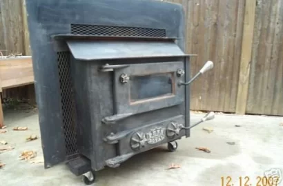

I know cheap isn't always the way to go, but in an effort to keep the purchase cost down, along with shopping new stoves and inserts I have been browsing craigslist alot. I came by a stove insert made by a company called Royal Penn (or Penn Royal, I'm not sure.) Now I can't find anything online about them (I'm assuming they went out of business or were purchased by someone else) nor can I find any forum topics on here.
Does anyone have any insites into this manufacturer of stoves? The model I'm looking at is a 3421 and I have attached a picture or it.
Yeah I know it looks like I need to give it a good cleaning and a new shot of high temp paint, but I'm not going to pull the trigger on the unit I can find some info on it (or if the info I find is that it's a bad purchase.)
Can anyone help me out here?
EDIT: There is a UL tag on it, so it is not pre-UL

Today's modern, EPA approved, stoves/inserts are truely worth the price. It takes a lot of work to install a new unit in place. The insert, the liner, etc. AND, most importantly, the new units provide a significantly greater heat ouput to you for the investment. If on a budget, you might go to a local dealer and see if they are going to be selling off any floor units at reduced prices. This is an investment you will live with for a long time, my suggestion would be to go for the most efficient, clean burning insert you can get. (Not sure if the one in that picuture is it)
It's hard to recommend an old smoke dragon. The stove sure looks stout, almost like it was built for coal. I'm curious about the upper controls on the door, do they functional or just for looks? It looks like an early attempt to add secondary air. Is there a baffle above the firebox?
Note, if the old Penn has an 8" liner requirement, the installed liner will be oversized for most EPA inserts (in case you intend to upgrade later) and more expensive to buy, insulate, and perhaps harder to install.

I'm not sure if they have fixed it or not, haven't been to a big box store in awhile, but there were some weld failures in some of the century/dutchwest inserts that were fairly serious. When looking at the inserts, pull off the grille and see if the entire firebox is top suspended or if there are bottom supports.
