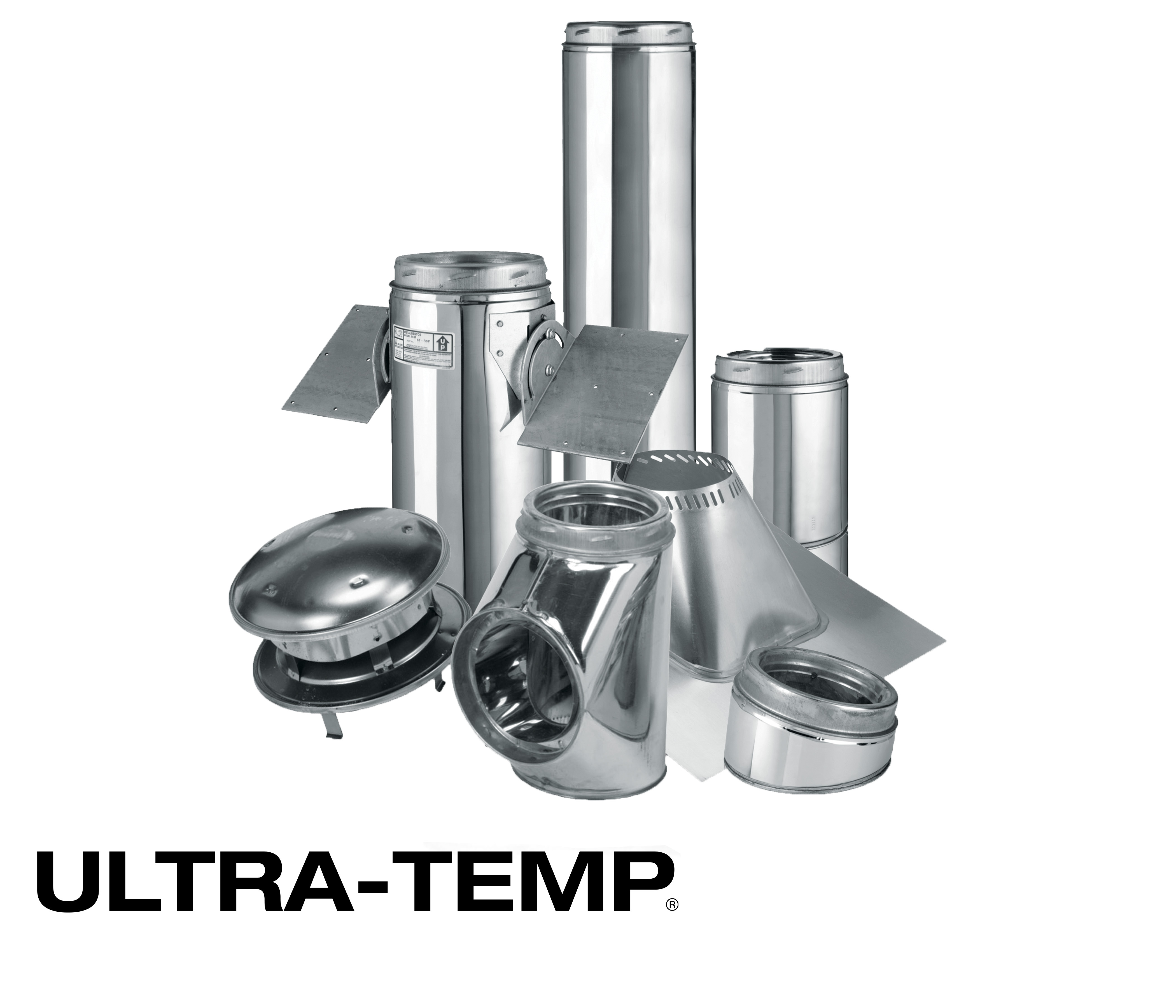

Regarding your chimney story. I am hoping my chimney holds up. I am using Selkirk Ultra-Temp. I believe it is their most premium chimney pipe. The page states it is:
  • 304 Stainless Steel Inner Liner
  • 430 Stainless Steel Outer Wall
I will update the forum as things progress. I'm hoping everything is plumbed in within the next few months.
316ti SS chimney pipe/liners is what is recommended for coal (fine for wood too)
