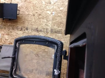

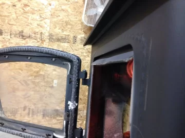

I bent it mostly back straight but the weakness in this stove (that I've found) is the airwash plate at the top of the door. It's really really thin. Look for sags here.
I've never had this stove over 750. Monitored excessively. It seems to be holding so maybe some sort of built in manufacturing flaw? The stove has some very well thought out design features but a little more heft here would be great.
