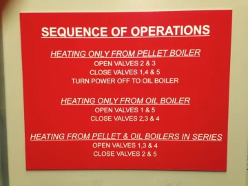

I just want it low enough to ensure me that the PB is not coming on. But I agree with you that its not foolproof unless after it goes through the PB Ranco I do the induced fan relay like yours. Or just do it like your set up. Here is my crude diagram. Nothing fancy just showing valves I use to change flow and my valve operating chart.

Your system is definitely different than mine, so maybe my solution isn't like yours should be. Although, I do seem to remember that at one time, my protection scheme involved the PB temperature.
I'm thinking if the pellet boiler isn't running, the thermobloc also isn't running so there's no circulation through the PB. So, the temperature will go down very slowly. So, even though it took a while for the PB temp to go down, the PB temp should stay down there if the PB isn't running and this will keep the OB running.
I wonder if the PB temp can get below that 120 setpoint on a transient basis (I'm thinking probably not)? That would turn on the OB when you don't want it, ie, when the PB is running, and it would turn off as soon as the PB got over 120.
Thing is, if you're testing how the setup works when the PB fails, why not just turn it off and see how it works?
I plan on testing it this weekend when I have more time to monitor it. Have you ever tested your scheme that makes your OB come on when you run out of pellets?
