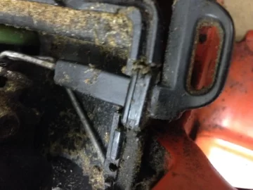

You guys helped me get the last Dolmar running like a beast so hopefully you can give me a hand on my newest addition to the collection. I have a Makita 520i that I've been running for at least 15 years. So I just got a Dolmar 111. Couple issues:
How does the choke work with the top cover attached. The choke is slotted into the case so I can't pull it back...how dumb am I!? Attached is a picture of the choke with the top cover off. As I see it, the choke pull is slotted into the case and I have to lift the lever to choke it. But I can't lift the lever to choke it if the top cover is installed.

I may be way out of line I don't know the saw But could the choke
lever assy be upside down . slide it out of case rotate 180 deg.and
reinstall . then lever would pull down from top cover not up toward it .
Or is it just a slider pull out on, push in off ??
Sorry I wasn't very good at explaining. The choke slider is a pull out and push in. But its slotted and so I can't pull it out or push it in. There has to be something obvious I am missing.
But I can probably getting it running sans choke...the slipping pull start I really need to resolve. What could that be? I know used parts are out there for these but I just don't know what the problem piece is.
That choke lever looks to me like it should just pull straight up to clear the case of the saw and then it can be disconnected from the carb if you want.
Well I am not trying to disconnect it I am wondering how to use it under normal starting. How do I pull it out if it slides into the case?
My suggestion is to take it out so you can see how it works. Also if I remember correctly there was a clip attached to the choke to limit the travel. I may have to take mine apart to confirm that.
I have a 112 and a 119 also and it may have been on one of those.
You know it may just need a good cleaning so take the choke lever out and see if the carb butterfly even moves.
Also is it a 111 or a 111i ? There is a difference on the carbs.
Good idea on the cleaning. The actual butterfly moves fine but Im gonna clean the mechanism real well and see what happens. Not sure if 111 or 111i. Will look again.

Ok just an update. The choke lever was just really stiff in the plastic housing so a little kroil fixed that up.
