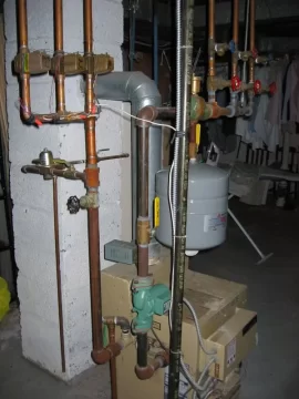

Gas boiler. I'm not an expert, just a wannabe DIYer.
woke up saturday to a bucket full of water off the relief valve. not sure if that was the problem so i replaced both that and the expansion tank (which was waterlogged) the day after.
anyway, everything was fine after install. bled the lines. started the boiler up and inspected for leaks every 30 minutes. 5 hours later...woooosh! about a quarter of a bucket of water from the PRV as I was watching it turn on. I'm assuming my gauge is shot because the pressure is stuck at 15, but temp on the gauge goes up and down when boiler calls for heat. drained it again and no leaking for the next hour
woke up today and you guessed it, another 1/2 bucket of water. what else could it be. gonna try and get a new gauge and new PRV again, but would like to hear your thoughts....
