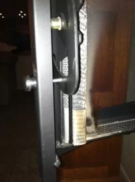

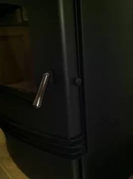

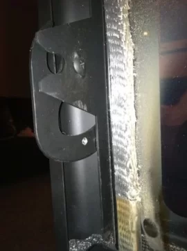

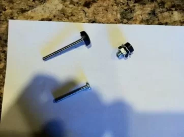

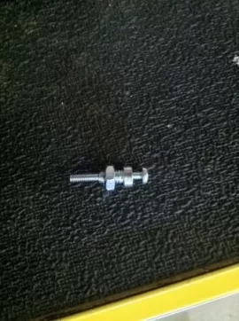

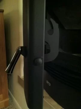

I used a 5/16x1/2" bolt, drilled through it and tapped it to 10-24. Then I rounded the hex so it looked a little smoother. I found a black round cover for the 10-24x1 1/2" machine screw, and it makes it a nice handle to turn the "lock screw" a couple turns out to unlock it. I have a knurled screw ordered but this one may just work out fine. Plus, not that it gets hot, but the cover makes a nice heat shield for the screw-head. I eyeballed the door to hit the inner part of the latch on center as seen by the pencil marks on the door around the installed part, drilled it, installed the bushing and latched the door. I used the bushing as a guide for the inner hole so it lined up perfect, and money.
The Wifey looked on from the couch antagonized because I was going to break the new expensive stove with my cordless drill.
So far so good, and it is nice and solid. Like I said, at least until she learns lefty loosey.

That looks great. It looks like it will do the job AND it looks like it belongs there!
X2! Looks prOfessional
