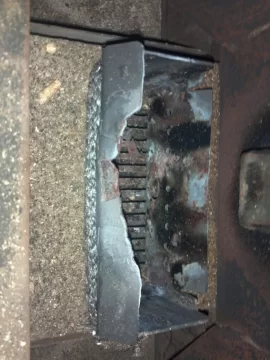

Next time you see the stove take a close look at the burn pot to see if there is space between it and the holder. I tied a small piece of rope gasket around mine to seal up this gap and now no more pileups whatsoever
This is a pick ....the gasket is literally tied around with a knot....at the knot I supplied a little gasket cement.
Make sure to use a thin gasket so the igniter hole still lines up.
