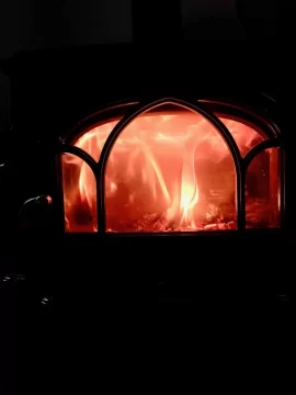

Just got a call from my mom, she put a load of wood in her Oslo and it started to over fire, temps climbed and no secondaries. Because of the knowledge that I learned on this website I knew a door wasn’t latched. Had her check and sure enough the ash door wasn’t shut right. I can’t thank you guys enough for the wealth of knowledge that is in these pages.

Nice job! You may have saved her from a cracked base on the Oslo or something even worse.

Real common issue. When pulling the ash pan, you get ash in back of the pan. The door wouldn't close. You need to to get down there and clean it out.

Xman - Good reminder - that was probably the issue. RSFBurner should call his mom and have her check. When she adjusted the door, it might have solved it for now, but the next time she uses it, it may not be able to close enough and the near over-fire will be repeated.

I learned that lesson within the first few weeks when I went to close the ash pan door and it would not securely latch.
Now I use a short handled fireplace tool set with a flat pan shovel to quickly clean out any ash that accumulates behind the pan. It's an easy-peasey 1-2 minute job.
