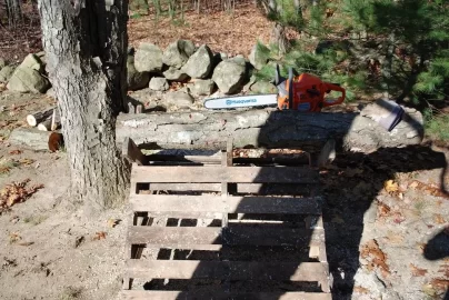

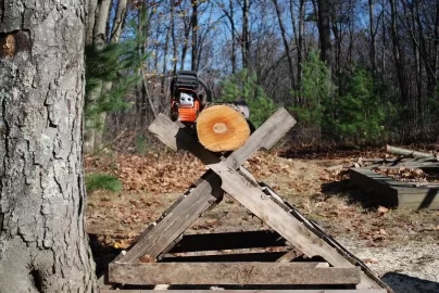

I got this idea from someone on the forum. Works great and less work to build (assuming you have extra pallets).

That looks good

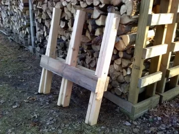

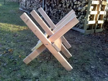

Hi There,
Had a little time today, so I made a collapsible one for $5.80. Works like a champ, but I forgot to take pics while cutting--sorry.

Thats take it one more step. I like it.

Shari - look at my 2nd picture (side view). If you look close, there are 4 markings (every 16 inches). I mark these ahead of time so there's no guessing.
Cut 1 - Right side first and this falls to the ground.
Cut 2 - Left side and this drops into place
Cut 3 - Right middle and these two drop into place.
Remove three logs and reload with next 64" peice for cutting making sure the right side has enough overhang to drop after cutting.
Ths is my first year using a saw buck and it really makes the whole process quicker and a lot easier on your back.
