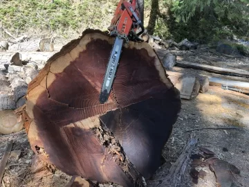

Nothing wrong with a 450, but you're not going to cut "monster size stuff" with a 450 wearing a 20" bar. It just isn't going to happen.
Can be done but it is a real pain in the ass to do.

Nice! But unless I’m forgetting something from my 9th grade Geometry, there’s no way to get a 20” bar to the center of a 50” tree.

Oh, definitely. And you can easily fell a tree with DBH > 2x bar length by plunging the bar into the middle of the tree at the face cut. But that technique doesn’t work for bucking logs, you need a bar length > dia/2.
